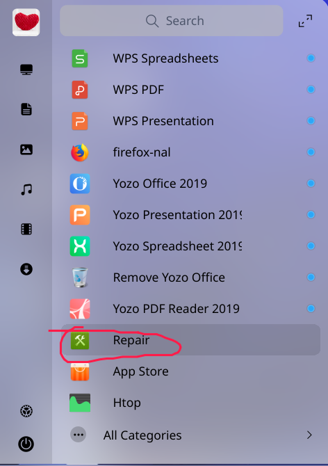

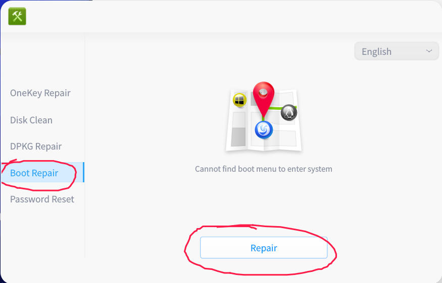

2021-04-20 07:58 Try to this step:
1.Use command to install deepin repair tool:
sudo apt-get install deepin-repair-tools
2.Open the repair tool
3.Select the "Boot Repair" menu and click the "Repair":
4.If deepin repair tool does not work ,you can start to PE and use NTBOOTautofix to fix it.
