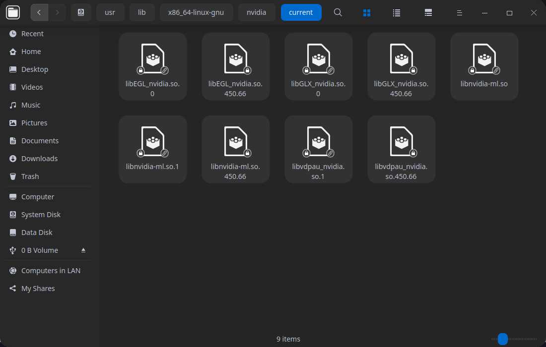

c***b@daleybortolon.com.br
2021-01-13 00:06
2021-01-13 00:07
I have fewer files than you! What am I missing?
During the primus installation it was suggested I installed nvidia-legacy-390xx-driver-libs-nonglvnd. I'll do it and see if it changes anything.
