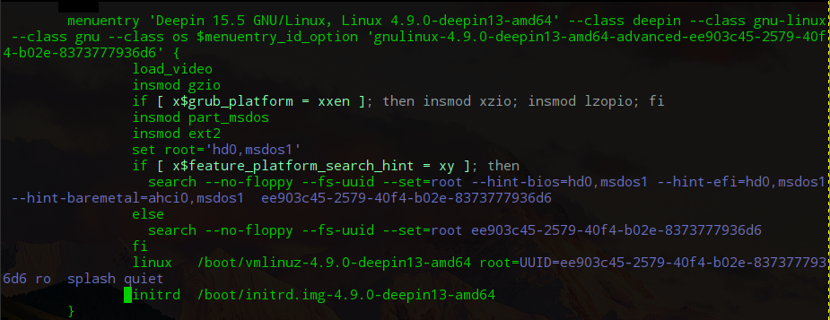

try this:

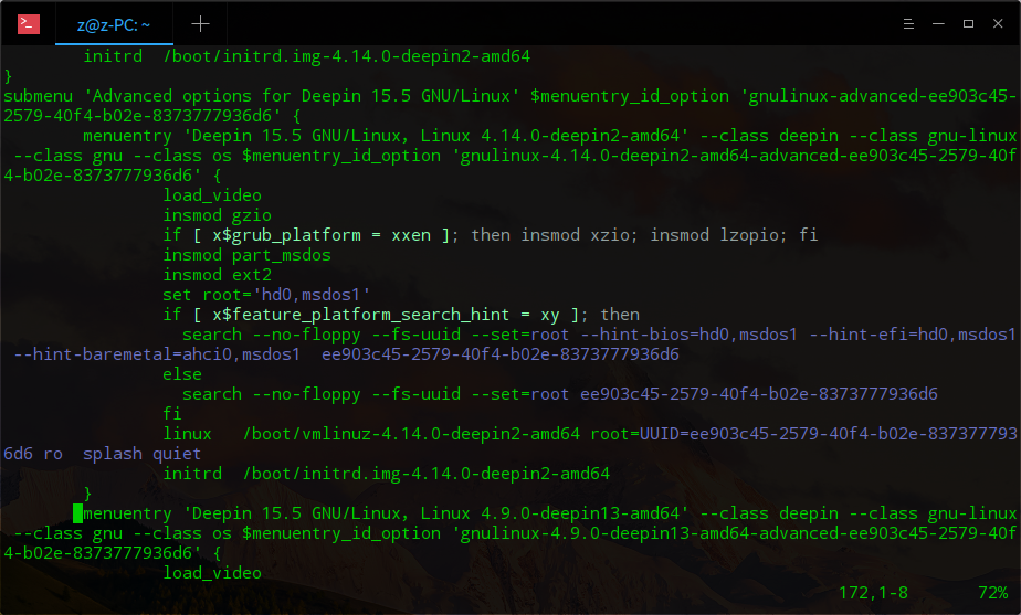

1.find the file:/boot/grub/grub.cfg.
then copy some codes in this file:
it's behind the codes like this:
Copy the Code

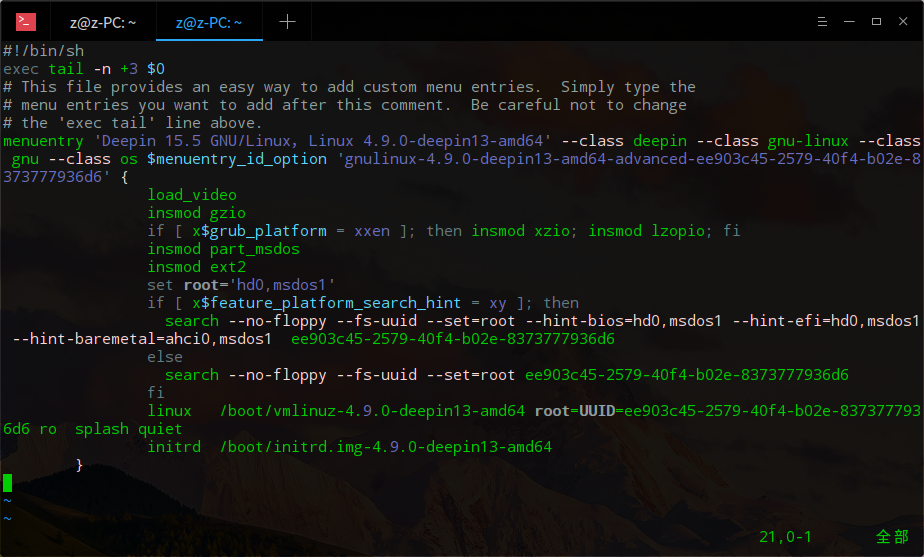

2.paste the code in this file :/etc/grub.d/40_custom
like this:

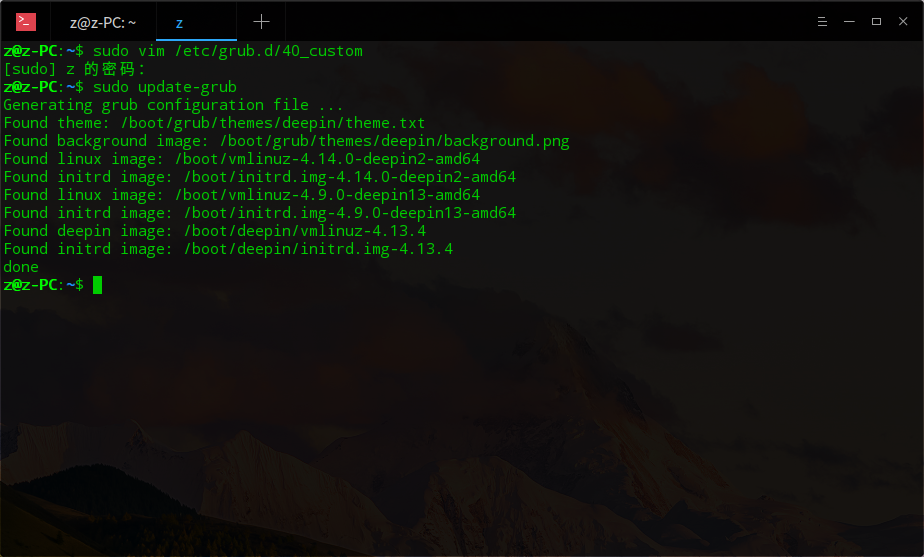

3. type in command:sudo update-grub

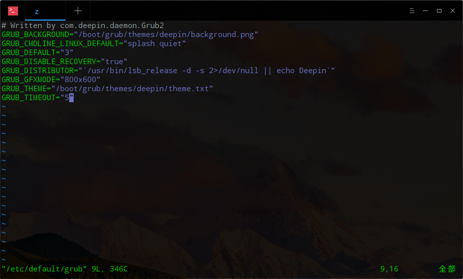

4.find the file:/etc/default/grub
and change fourth line:
GRUB_DEFAULT="0"
to:GRUB_DEFAULT="3"
5.type in command:sudo update-grub
after these these steps the computer were supposed to boot the kernel 4.9 by default
