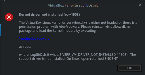

Hi, although this error is common on the internet however I couldn't fix it after trying many commands in many ways that I found on the internet forums.
I got this error after follow this https://bbs.deepin.org/post/37873
modprobe: FATAL: Module vboxdrv not found in directory /lib/modules/4.14.0-deepin2-amd64
Version Deepin 15.5
Thanks

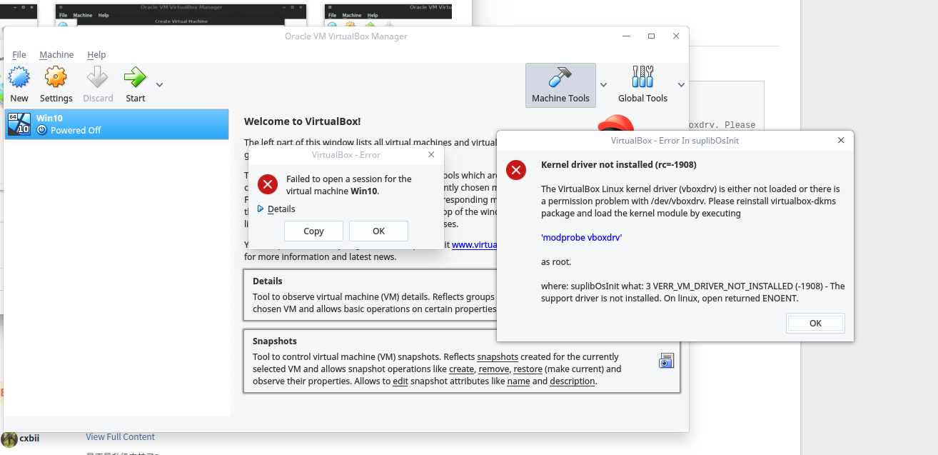

Same problem here, after upgrade to 15.5
Deepin version: 15.5
VirtualBox version: 5.2.2
Tengo el mismo problema, luego de actualizar a la version 15.5 virtualbox da ese mensaje y no puedo usar ninguna de mis maquinas virtuales.
