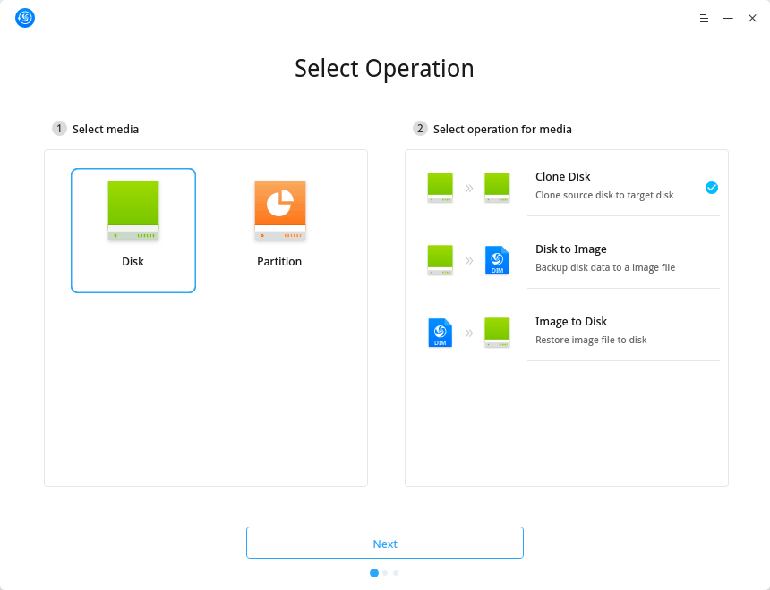

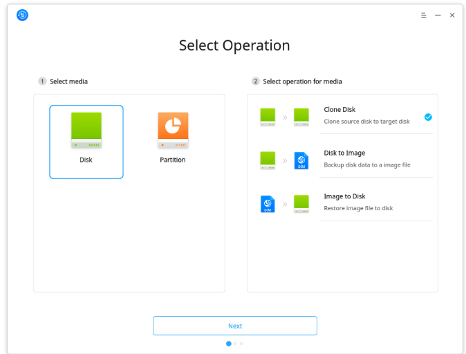

What would be the best approach to this ? I have tried the Deepin clone tool, but it doesn't let me clone a partition that is being used.
Do you mean that you want to backup disk on the device you sre using now?
You can only choose these three options.

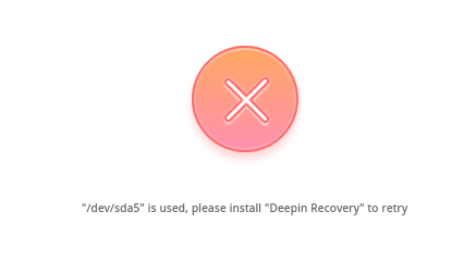

I mean when I choose to backup a partition, it doesn't let me backup the root partition (=the one being used). See here (right-click "Open image in new tab" to see it bigger) :
This is the error message at the end :

Try to install live-filesystem
  1. rhett@rhett-pc:~$ apt policy live-filesystem
  2. live-filesystem:
  3.   Installed: 1.0.1+201711081733
  4.   Candidate: 1.0.1+201711081733
  5.   Version table:
  6. *** 1.0.1+201711081733 500
  7.         500 http://packages.deepin.com/deepin panda/main amd64 Packages
  8.         500 http://packages.deepin.com/deepin panda/main i386 Packages
  9.         500 http://proposed.packages.deepin.com/deepin panda/main amd64 Packages
  10.         500 http://proposed.packages.deepin.com/deepin panda/main i386 Packages
  11.         100 /var/lib/dpkg/status
Copy the Code
  1. sudo apt install live-filesystem
Copy the Code
When installed, restart your pc, In boot menu you will see 'Deepin Recovery' menu, boot into this system, then you can backup your system
mike235
2017-11-28 04:53
The live-filesystem solution worked, thanks.
