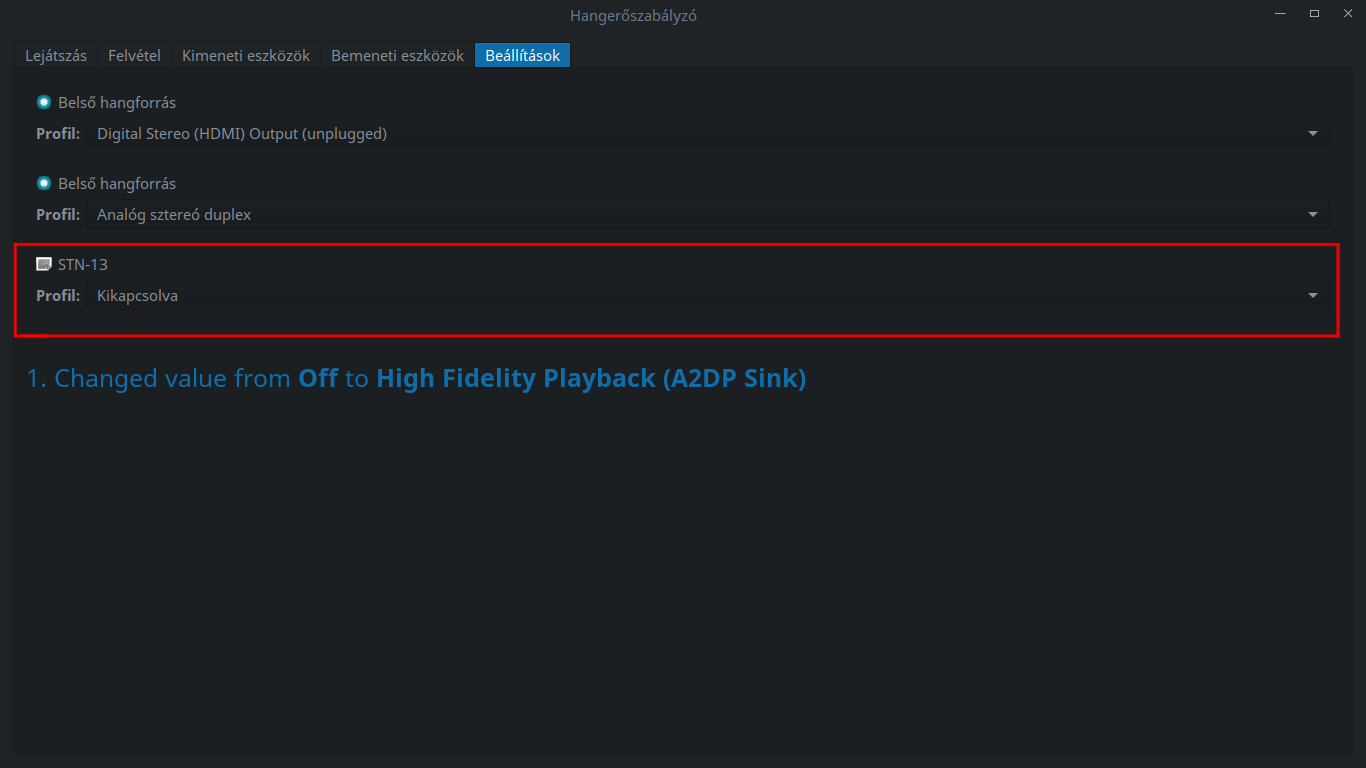

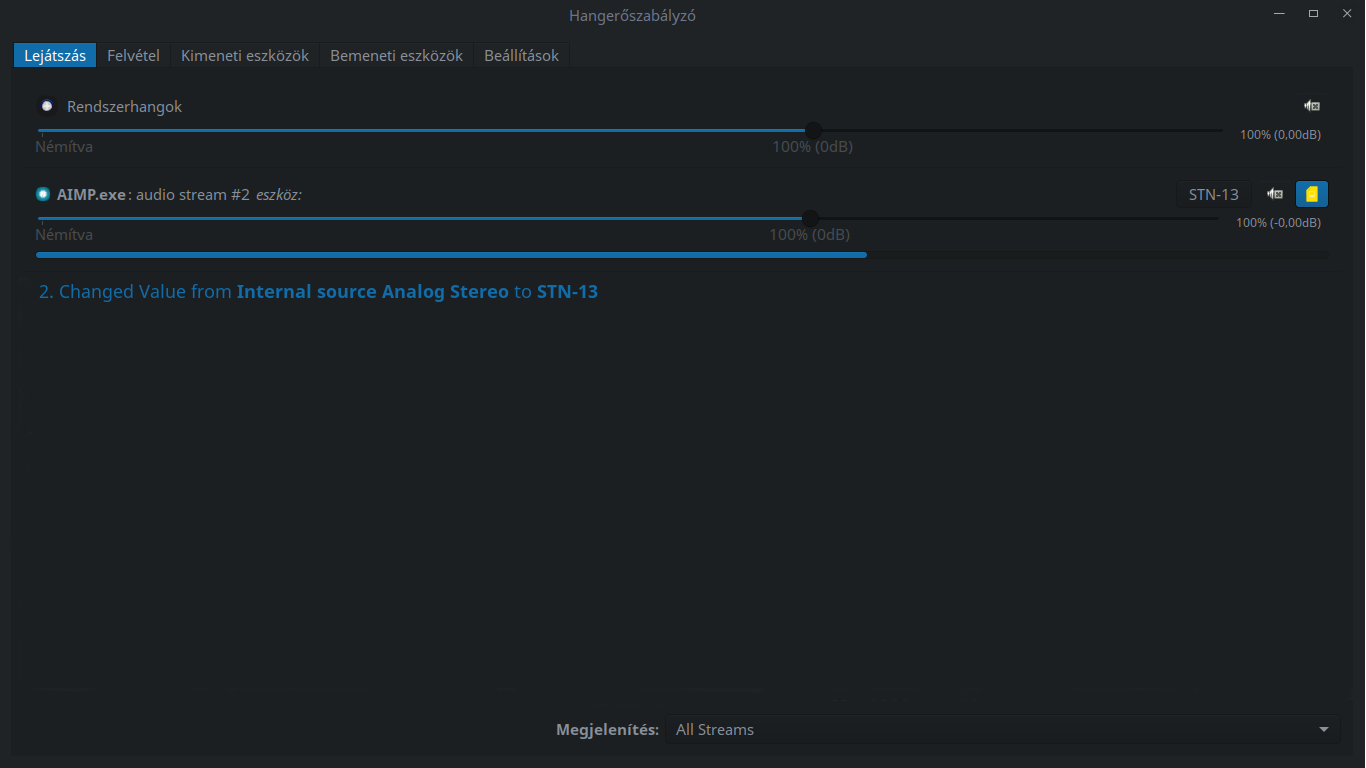

I have Deepin 15.3 x64 installed and STN-13 Blutooth headphones. Deepin found it and could connect to it, but there was no sound. I started my favorite music player but the music came from the speakers instead of the headphones. There was a 'Handsfree' option under Advanced settings under Audio, but the system got muted after selecting it instead of playing music on the headphones. There's nothing wrong with the headphones, they work perfectly with my old (Nokia C2-01) mobile phone. So how can I use Deepin with the Bluetooth headphones?
